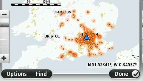

I spent too much time sorting out a picture and measuring it on Google maps, so didn't see dhn had already replied (Grrr....), but here's my five-pennyworth....

To answer your questions, yes it's a circle around your current location, and no, you don't need to have a route planned. If you just tap on the traffic bar on the right of the screen and select "View map" it will show you everything within the radius.
From my home in west London, that currently means I'm seeing traffic problems as far north as Birmingham and Leicester which is about 97 miles or 156km to the furthest one as the crow flies.
I was pleasantly surprised by that!
attachment.php
