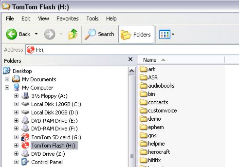

If you are using a PC then you SHOULD see the internal memory and the SD card slot as two separate drives. even if there is no card in the slot (Macs work differently and only show the card slot when a card is actually in the slot.

Previously I used to be able to see the device and the SD card with a TT name on my computer, now I can only see the SD card....
What do you see if you connect the TT to the computer WITHOUT the SD card inserted?
I'm thinking the internal memory my have physically died.
.....which has another name not the TT name.
That may depend on you having a file called "autorun.inf" on BOTH the internal memory and the SD card.
This file is a standard part of the TomTom system, but won't necessarily get installed on an SD card unless you put it there yourself.
The file is a standard text file, which you can edit in Notepad to set the on-screen name to be anything you like in the "label" line and also set it to use two different icon files for the two storage locations.
Mine used to look like this:

...and my icons look like this (see the tiny SD card on the logo):
attachment.php
Since I took that picture I've modified the labels again to add the Model number too. Useful if you have more than one device to connect!
