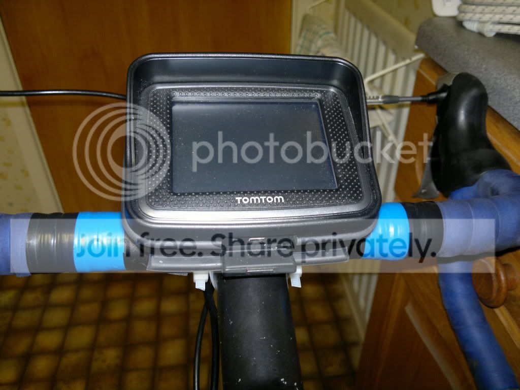

Hello,
This is NOT a "Wind-up", I do Audax, long distance cycling.
I've been using this setup all year with great success.

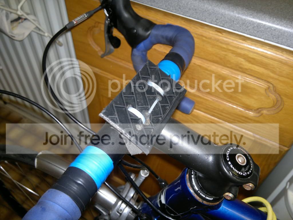

The handlebar mount is a piece of Range Rover interior trim cut to size and zip-cliped on.

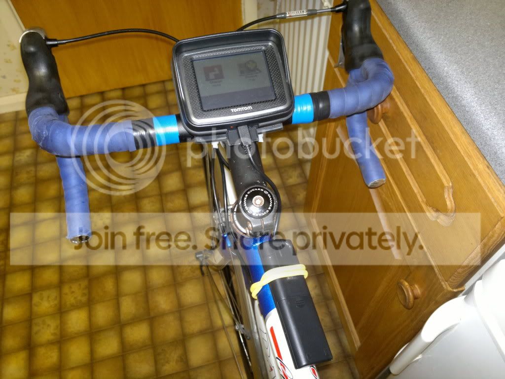

The battery pack ( 4 x AA ) was a tenner off Amazon.
Fully charged, this gives me 13 hours of good life. Longest ride this year 12 hrs 50 mins, 225 km.
No problems whatsoever. Rider's ETA is based on 12.5 mph average speed, which is what I like to do. I took 1 1/2 hours stopped at several cafes en-route which accounted for the near 13 hours total time.
Superb.
I break the route up into sections and make an Itinerary. Route plotting is far,far better than Garmin eTrex and Edge series.
I bought the unit etc off the TomTom stand at the 2010 Gadget Show at the NEC.
I'm well pleased.

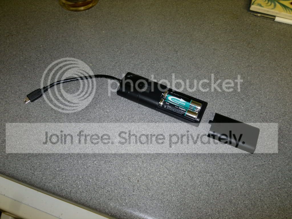

Here's a battery pack that is better than my modified unit. I resoldered a Mini USB lead. This one has one already.
The battery -ve compression springs needed tweaking to give better contact security when vibrated. To get at them, there is a x-head screw under the decal. It comes apart easily. When reassembling, a lick of silicone sealant won't hurt.
Its been out in the pouring-down rain and survived admirably.
With both Rider and the battery pack charged, it gives a good 12 hours of life with full screen lighting and Bluetooth earpiece operating.
If I ever ride a 300 km again ( 17 hours ) I'll stop en-route and purchase a pack of AA Alkalines when the 'battery indicator' gets to red.
